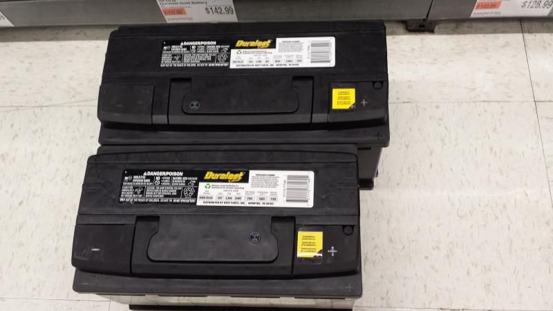

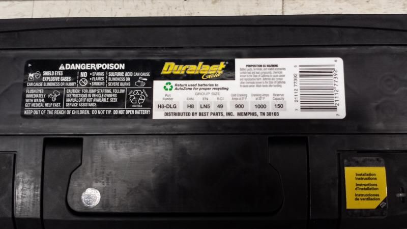

I just picked the batteries off the shelf to compare
H8-DLG AKA 49R
